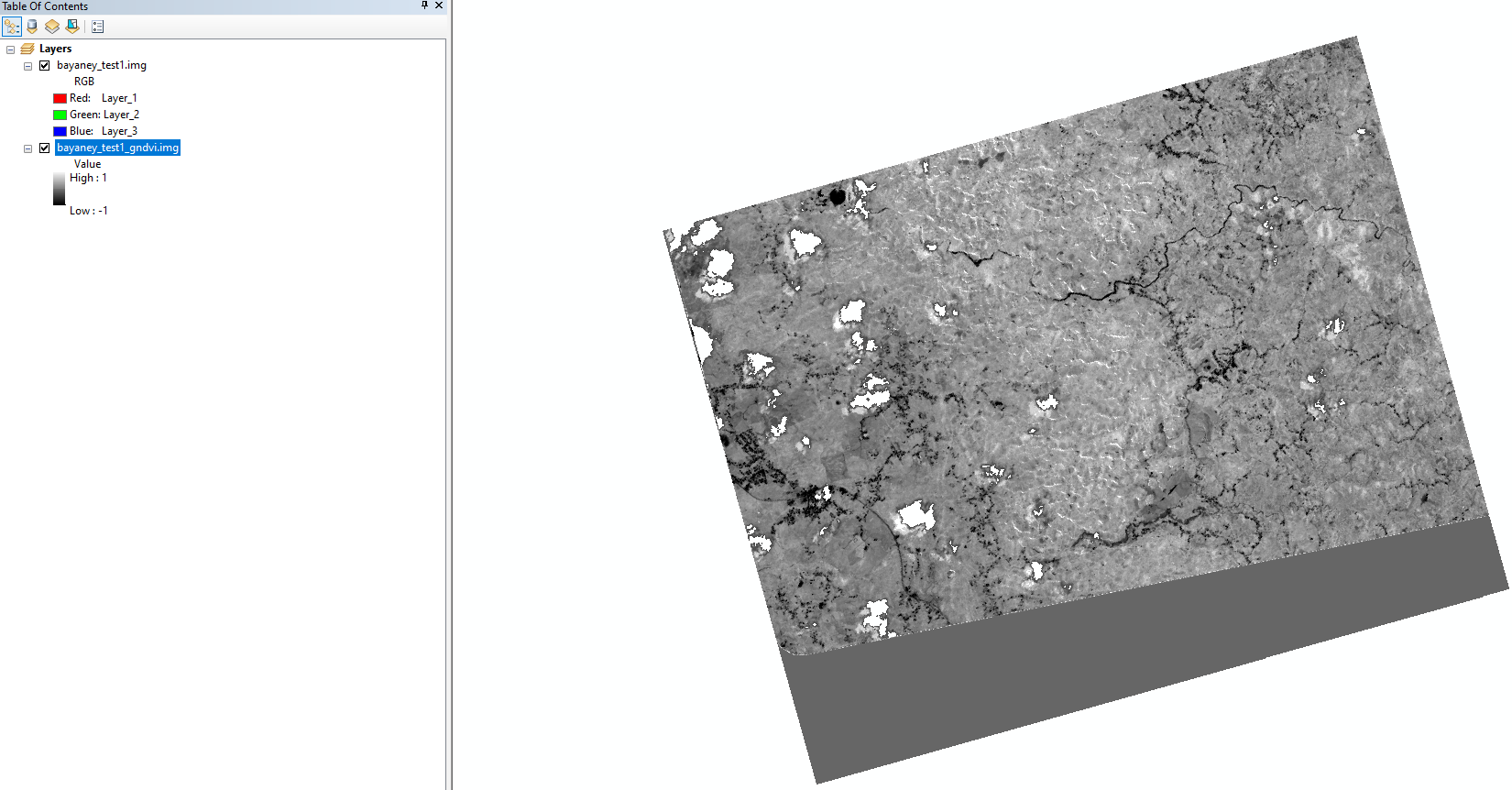

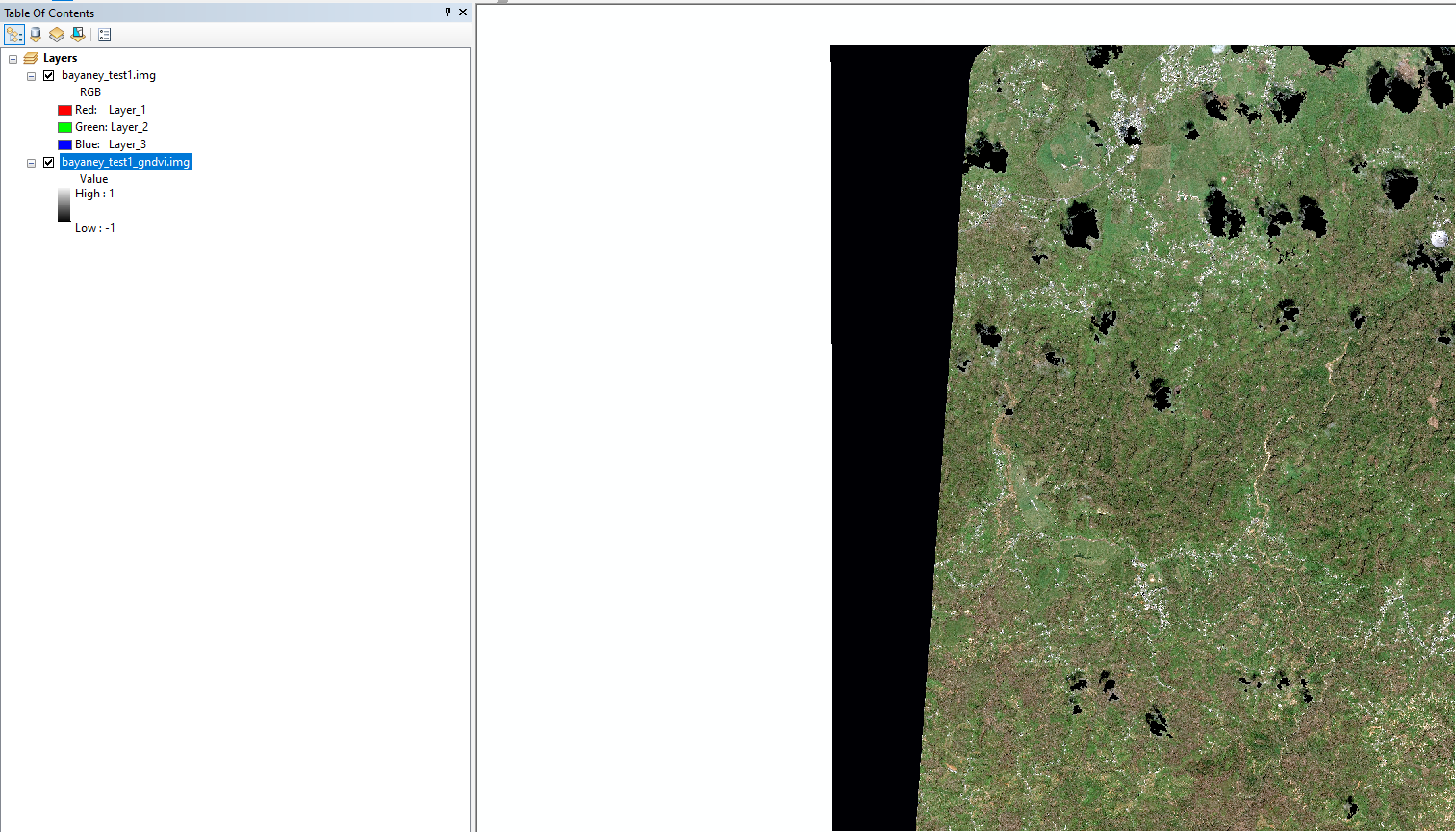

My problem is when I add my original image to ArcMAP it opens fine, but after i add the image processed in Erdas image it do not align with the other and is too far and is turn around. How can I fix it? i am using arcmap 10.7.1

original image
original image
erdas image after process in ArcMap
erdas image
