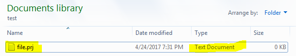

Walter, if you haven't clicked the box in Windows Explorer to turn off 'hide known file extensions' and rename a file to file.prj, it's "real name" is still file.prj.txt, the extension is hidden.
I turn that setting off as the first thing I do when I get set up with a new windows login! I am grateful that although Esri added this as an option inside Catalog, the default is OFF (don't hide extension).
screen shot of windows explorer with hide extensions of known file types checked
