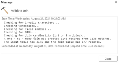

  4. If you create a join from the point layer to the polygon layer (via Add Join), what kind of join is it? One-to-one or one-to-many? Can you check to see what the Join section in the layer properties says? Did Pro force a one-to-one join, despite the data being one-to-many?

 4. Here is what happens when I do a join of the Points to the Polygons. (There are many more records of polygons than points). This Join seems to work well and I may have to work from this data. Working backwards may be the key Because the 1:M join does work where as the other way around it does not.
