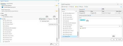

Using Export Features, adding a new long type field and mapping it to the OID field of the target feature class will reliably create a dataset that contains the original OID values in the new output field.
Here's a quick step by step:
  1. Expand the 'Fields' section in Export Features.
  2. Add a new field in the field map by selecting the drop down arrow next to 'Add Fields' and selecting 'Add Empty Field'.  In the example image I've called it Original_OID.
  3. Select Edit to configure the field.
  4. Make sure that the output field type is Long (32-bit Integer)
  5. Add the ObjectID as the source field.
  6. Click Ok in the field map.
  7. Click ok to run Export Features.
