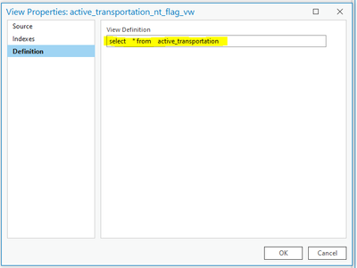

The viewing part was implemented in 2.7 thanks to this idea: ArcGIS Pro should allow you to see the SQL used to... - Esri Community
3:42 in this video: Ideas in ArcGIS Pro 2.7 - YouTube
So this idea would be about editing that query.

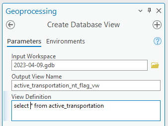

It looks like it's possible to replace a database view using the Create Database View geoprocessing tool. The key is to create a view using the same name as the existing view.
That will replace the existing view. (Although it's unclear if it modifies the existing view or just deletes it and creates a new one.)
With that said, I think this idea is still valid. It would be best if we could edit the SQL definition of the existing view from the view's properties in Catalog:
That would be more intuitive.
SSWoodward
@Bud , This workflow will work as long as you have the 'Allow geoprocessing tools to overwrite existing datasets' option clicked on in the geoprocessing page of the options menu.
Without this clicked, the workflow will fail with 'Table already exists'.  The GP tool is creating a brand new view and not editing the original in place.
