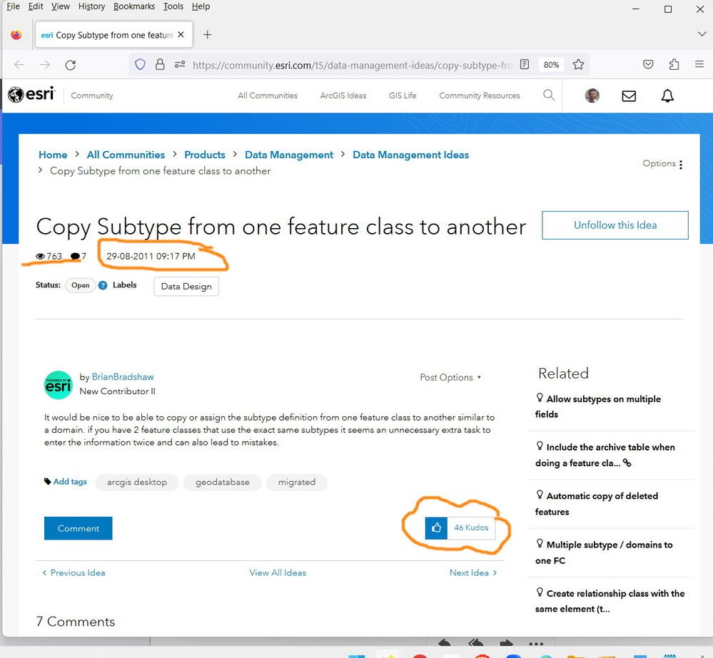

BrianBradshaw
Deactivated User
It would be nice to be able to copy or assign the subtype definition from one feature class to another similar to a domain. if you have 2 feature classes that use the exact same subtypes it seems an unnecessary extra task to enter the information twice and can also lead to mistakes.

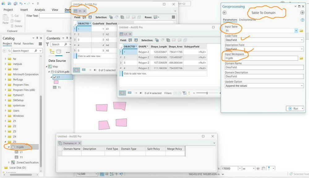

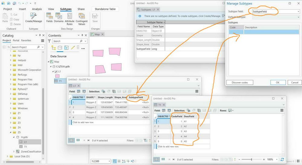

JamalNUMAN
How to “import” and “export” values to the “Subtype”?
1.     The command “Table to domain” and “domain to table” are used to transfer data from and to the “domain” of the geodatabase.
2.     Why we don’t have a command that transfer data from and to the “subtype”?

JamalNUMAN
This appears not to be developed even in Pro 3.0.1
This tool is already available when it comes to importing domains saved in table

HadeerSamy
Hi There, I've faced the same issue while working on a project, So, I've developed a python script toolbox to solve this issue.
It only takes 3 parameters:
  • input layer
  • input subtype field to assign to
  • subtype layer to copy from
you may find it in the following path Copy Subtype  and an elaboration to the tool in the following link Copy Subtype between layers
