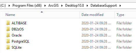

If possible consider to add this important info about the dbtune keywords back into the documentation (Oracle, SQL Server, PostgreSQL) and continue to provide a dbtune template file going forward, a good place to find it would be in the ArcGIS installation under the Database Support folder.
