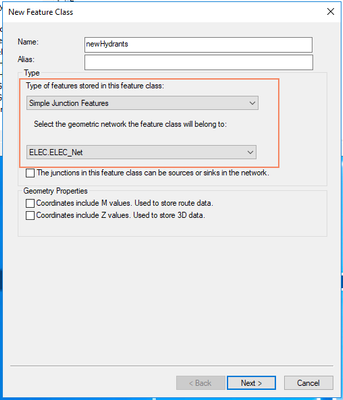

If a user right clicks on a Feature Dataset (which contains a Geometric Network) -> New -> Feature Class.
In the New Feature Class Dialog, the user is allowed to select ‘Simple Junction Features’, ‘Simple Edge Features’ or ‘Complex Edge Features’ as the feature class type.  And then a drop down of available Geometric Networks will appear.

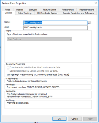

Following the standard new Feature Class wizard, the feature class is created (and registered as versioned)

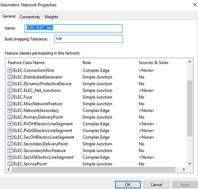

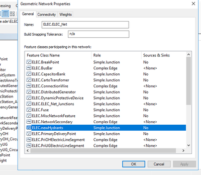

And registered as a source in the Geometric Network
Here’s the new classes properties (registered as versioned)

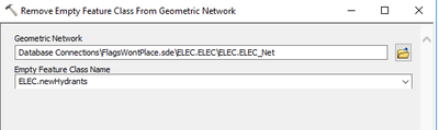

If the user, then decides they no longer want the class in the GN.
The user can delete all records from the table and then use the GP Tool: ‘Remove Empty Feature Class From Geometric Network’
Following that, the class is now no longer in my GN:
