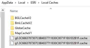

TedHoward2
This is likely due to local caching that Pro does. Here are a few things to try:
  1. Refresh the packages from the Environment Manager. Then create a fresh clone and install dltsolutions.TedHoward2_0-1685650327436.png
  2. Try importing dltsolutions from the python window to ensure that it imports with errors
  3. Clear your geoprocessing cache which will force it to rebuild when you restart Pro. The cache is found at AppData/Local/ESRI/Local Caches. Delete any .cache files.TedHoward2_1-1685650571236.png
