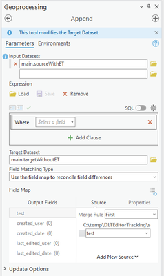

We were able to repo the issue and narrowed it down to a change in how the FieldMapping object auto matched rows.  In 3.1, the ET fields do not auto load.  You can see this by just using append(screen shot below, notice how the ET fields have a (0) next to them, showing they did not match the source to target fields).
We have fixed this the DLT loading tools and finalizing some testing.  I hope we can get an update on conda next week to resolve it.
