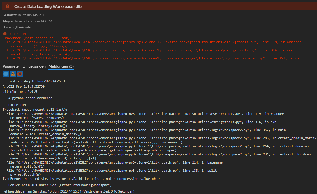

I have a problem importing my data. I'm using the tool called "Data loading tools" and I want to create a Data Loading Workspace (dlt). When I run the tool, the following error message appears.
Does anyone have experience with this and can help?

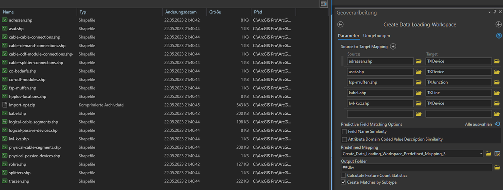

I am using Shapefiles.
TedHoward2
Shapefiles are supported so something strange is happening. It would help to see the "Source to Target Mapping" value from the Parameters tab.

There is a problem handling parameters when is localization installed. Should have a fix in the next day or two.
TedHoward2
This should be fixed on dltsolutions 2.9.6
