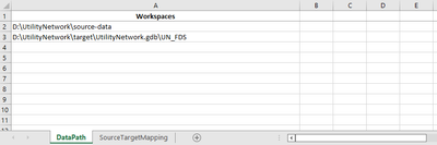

What I want to do now is to automatically update the Paths in the Source and Target columns. My first approach was to update the paths in the "DataPath"-sheet as shown here:
workbook_source = reference_workbook+"\DataReference.xlsx" ('reference_workbook' contains the path of the DataLoadingWorkspace folder)
workbook = openpyxl.load_workbook(workbook_source)
worksheet = workbook.get_sheet_by_name('DataPath')
fd_string = str(featuredataset) (featuredataset contains my UtilityNetwork featuredataset)
worksheet['A2'] = source
worksheet['A3'] = fd_string
workbook.save(workbook_source)
When I run this code, my data paths are updated. This is how the DataPath sheet looks like after running my code:

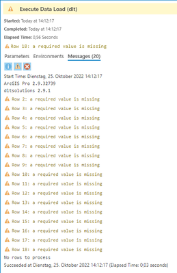

It looks good. When I manually create the DataLoadingWorkspace with this source and target paths, it looks excactly the same. But when I try to execute the data load, nothing happens. In fact, i get the following messages:
Which required values are missing here? Sadly I could not find some help online.

A couple things may be happening here but I believe it has to do with a limitation with openpyxl and excel workbooks that contain formulas. Excel caches formula results so you need to open your DataReference workbook and hit save. This enables openpyxl to properly read the rows in the DataReference workbook during execution of the Execute Data Load tool.

Ok that makes sense. I was just trying to understand your workflow. So specifically in the DataReference workbook, there are formulas that pull the data path values into the Source and Target columns in the SourceTargetMapping sheet. You can see these by opening the DataReference workbook in Excel, selecting the Formulas pane and clicking the Show Formulas button.
The issue with openpyxl is that it cannot read cells that contain formulas if the Excel workbook was saved by openpyxl. It can only read these cells if the workbook was actually opened in Excel and saved (this is what I meant by Excel caching). In your case you are editing the DataReference workbook with openpyxl and saving it with openpyxl. When Execute Data Load tool runs, openpyxl is used to read the DataReference workbook and it fails trying to read the cells that contain formulas. The only solution is to open the DataReference workbook in Excel and click save. After this, Execute Data Load tool should work fine. Let me know if this does not resolve it.
Luca_Schikowski
Oh you are right! I opened the excel file, just saved it and it worked. I am not sure how I want to solve this issue, but atleast I know why it is not working.
