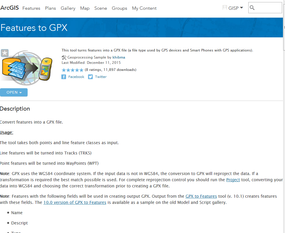

For what it's worth, http://www.arcgis.com/home/item.html?id=067d6ab392b24497b8466eb8447ea7eb  is a FeatureToGPX sample toolbox that I plan to look at for next year.  It was last modified Dec 2015, so isn't too old and may be worth looking at.
