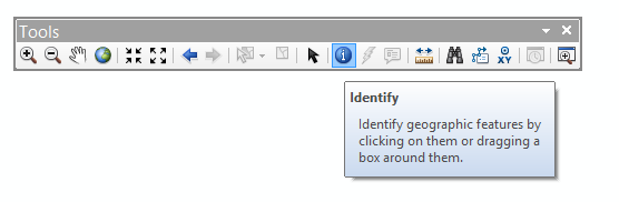

If you want to locate specific pixel you can use GO To XY tool in Tools bar
If you want to know the coordinate of any pixel , you can use identify tool
then click on the pixel and you will get this window
that have the coordinates of pixel.

Abdullah this was the solution. I very much appreciate you help.
