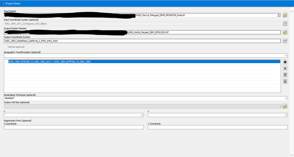

This is the Project Raster tool, in ArcMap, working without an issue with the same settings as what is on the script (Note the geographic transformation)

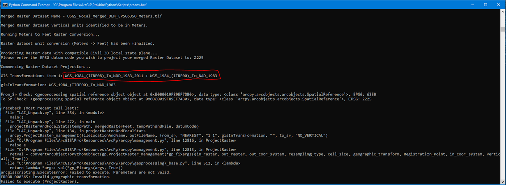

Here's what is returned in my Python Command Prompt when running the script (Note the program picks up the same geographic transformation "WGS_1984_(ITRF08)_To_NAD_1983_2011 + WGS_1984_(ITRF00)_To_NAD_1983"):

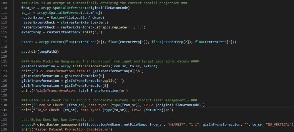

Here's the section of code on my script that is responsible for the return. (Note: I have tried various {geographic_transform} inputs for the ProjectRaster_mangement() tool, these being: "WGS_1984_(ITRF08)_To_NAD_1983_2011 + WGS_1984_(ITRF00)_To_NAD_1983", "WGS_1984_(ITRF00)_To_NAD_1983", and "WGS_1984_(ITRF08)_To_NAD_1983_2011" )
The end goal, for this instance, was for the transformation of a Raster file from NAD_1983_2011_Contiguous_USA_Albers to NAD_1983_StatePlane_California_I_FIPS_0401_Feet (as this is a compatible datum for Civil 3D), although I have searched solutions for this problem for a few hours and have had no luck,

I have solved this issue, due to the long hours working on this script, I overlooked the fact that my variables to_sr and from_sr were switched!
