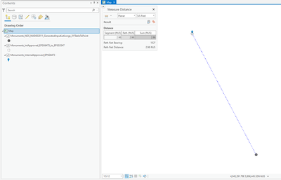

Hi @MelitaKennedy. Thank you for your advice. I have taken the following steps. I am limiting the conversion from EPSG/WKID 6473 to EPSG/WKID 3547. I have also installed the ArcGIS Coordinate Systems Data setup to ArcGIS Pro 2.9.2.
The first step I take is to import my control points into the map using Add Data > XY Point Data. I set the coordinate system to KY Single Zone, US Survey Feet, NAD83(2011), EPSG/WKID 6473 with a VCS of NAVD88, US Feet.
The second step is to project this data from EPSG/WKID 6473 to 3547. In the project tool, the geographic transformation is "NAD_1983_NSRS2007_To_2011_NADCON5_3D_CONUS_1". When I add this projected data from the map, it overplots the 6473 points at the smallest drawing scale. This makes sense as the new 3547 layer is being transformed:

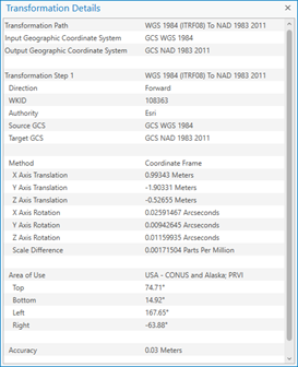

I then use the NGS NCAT tool (https://www.ngs.noaa.gov/NCAT/) to convert from NAD83(2011) to NAD83(NSRS2007). This generates the conversion report which I have attached. As before I take the input lats and longs and add them to the map using the XY Point Data tool and GCS_WGS_1984 as the coordinate system. The points are offset by 2.98 as before:

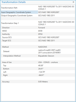

I can see the transformation that is being applied to the map:
There is nothing obviously wrong with this transformation. Do you have any insight into why this horizontal offset is showing up? Thanks for taking a look!
