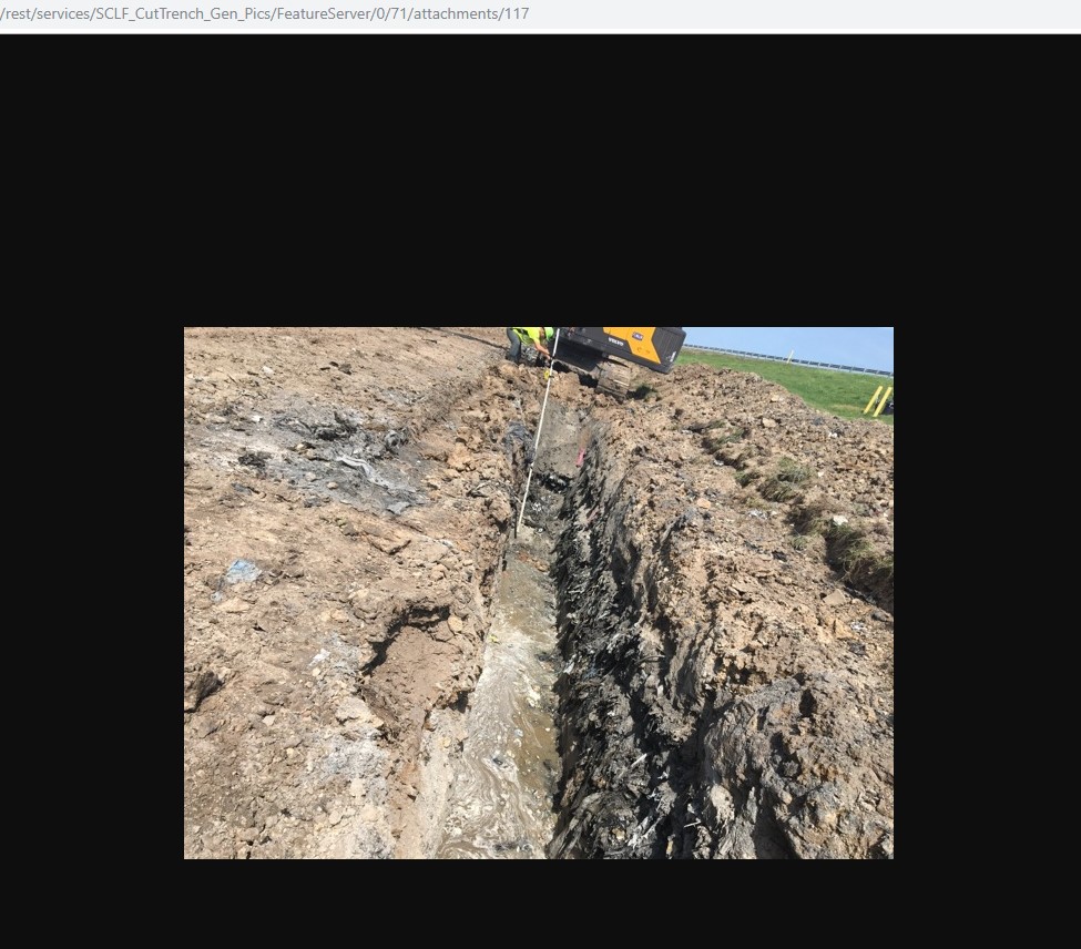

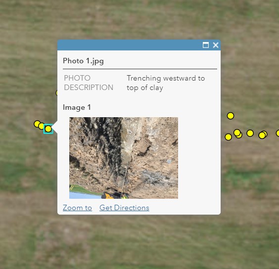

I'm currently having a similar issue except I'm using the feature attachment links to create thumbnails (preview the image in the pop-up) and the thumbnails are rotating, but when you click on the picture (which uses the link), the photo appears fine and in normal orientation. When I use shortlist builder and reference the URL for the photo, same thing, it rotates the photo. Examples attached. Stephen Sylvia
Edit: So browser matters too. Chrome will show the linked picture correctly, but Internet Explorer will rotate the picture (same as thumbnail).
