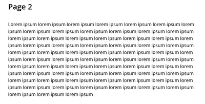

These are screenshots where I've replaced the text on the landing page and another page with the same temporary text to demonstrate the difference in line spacing. All other text settings between the two are the same.

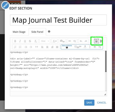

You mentioned you tried using HTML, but I wanted to check to see if you were editing HTML in the source view. Typically when there are formatting issues you can't fix with the keyboard or other toolbar tools, you can address them in the HTML source view.

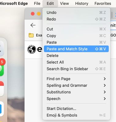

The suggestion I had was this option...
Correct, using Source view

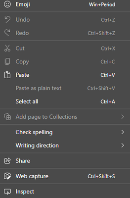

Unfortunately I don't have that option on PC with Edge; just "Paste as plain text".
