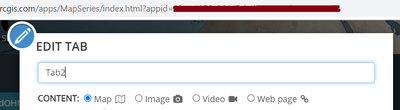

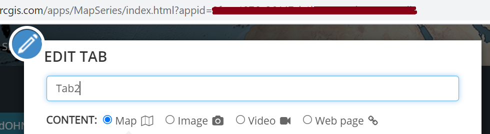

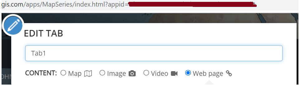

4) Created a Web Mapping Application using "MapSeries Builder" in AGOL
      a) In one tab configured webpage using created Web Mapping Application (WebAppbuilder)
      b) In another tab configured map using created "webmap"
