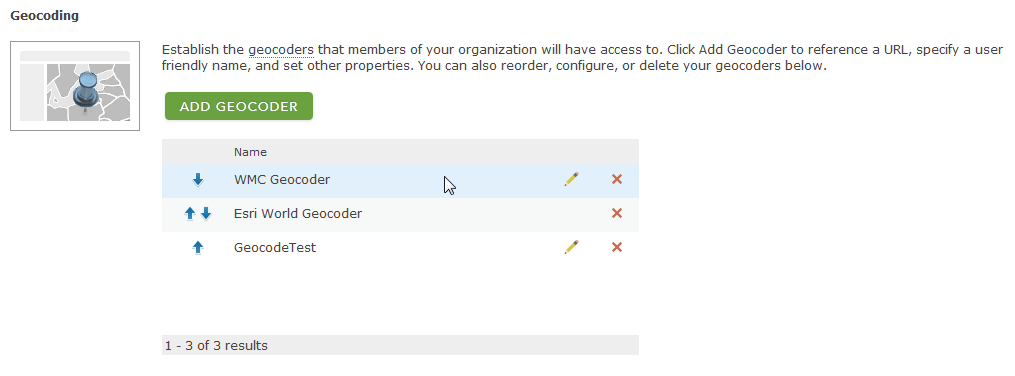

I've added a geocoding service hosted by ArcGIS Server with a REST service to our ArcGIS Online account as below:
The option to change geocoders shows up in the search bar in Map Series Builder edit mode:
However, in the live map - the option to change geocoders doesn't appear and it defaults to the Esri World Geocoder:
Any solutions?

With the upcoming release of ArcGIS Online next week, it will be possible to use custom Geocoder on organization that have disabled anonymous access in most of ArcGIS Online apps like Basic Viewer.
Unfortunately I was not aware of that issue and did not implement that new workflow so StoryMaps apps are not going to implement this capability until our September or December release. Until then, your workarounds are to enable anonymous access or download and configure the application to use custom geocoders.
Sorry for your trouble, hope you find a convenient solution in one of these two workarounds.

I think I found your issue, if I disable anonymous access in my AGOL settings, see screenshot below the geocoder will only appear when I'm in the Map Series builder. Not sure if this the expected behavior. I will ask ArcGIS Online development team if this is the expected behavior and get back to you.
In the meantime, if you can't enable that settings for security reason, the only option that I see for you is to download the Map Series app, host it on your own server and configure the geocoder list manually. Let me know if you want to take that road and I will describe the process more fully, as there is one trick to know to do that.
