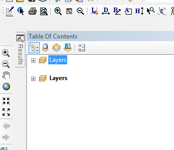

This works for me. I then resize the top data frame which is at the bottom of my table of contents. I have and have had various mixes of data.

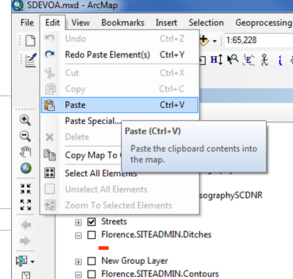

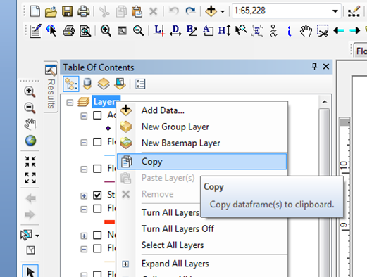

I believe one of the necessary conditions to do this is that one be specifically in Layout View.  Then it works for me if I follow these steps (ArcGIS 10.2.1):
1.  Highlight "Layers" in the table of contents, then right-click and select Copy.
2.  On the Standard toolbar, Select Edit, then Paste.
But if I am in Data View, one can Copy but not Paste (Paste is grayed out).
