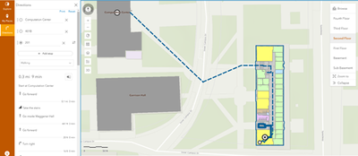

Data shown courtesy of the University of Texas at Austin.
