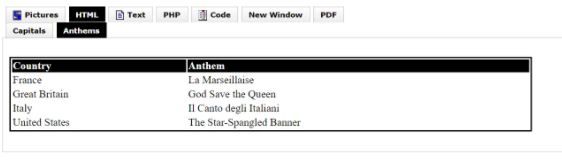

I see the example for tabs in the components. It is a two-level tabs
https://esri.github.io/calcite-components/?path=/story/components-tabs--simple
Is there a way to  define another level of tabs like this? Thanks.
link to image
