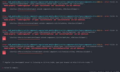

ForrestLin
Failed to compile with calcite-components-angular 2.0.0
No problem to compile with calcite-components-angular 1.11.0.
