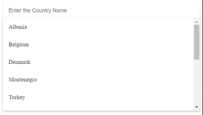

Is it possible to auto-complete input data from backend: web api/service, database?
