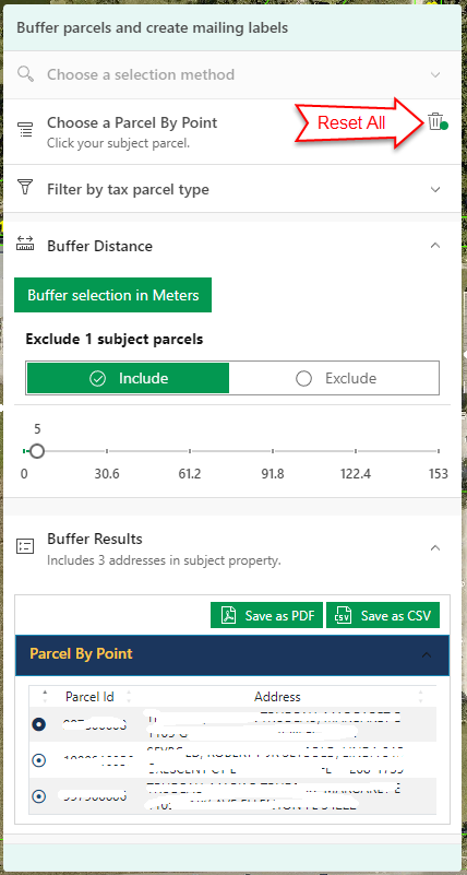

I want to reset the calcite-dropdown-item to a specific default item anytime a reset of the container is clicked. My code to reset it doesn't work as well as I had hoped. My workflow is to first unset the current selected calcite-dropdown-item and then set the default calcite-dropdown-item. I had to use dispatchEvent to set properties for other elements, but doing this was somewhat incomplete. My solution, which works, is to just remove the calcite-dropdown and rebuild it.

GregoryBologna
Ok. Thank you for the suggestion and example, Kitty. I wasn't able to get the Codepen example to reset. But that's Ok because I want to stick with the design I have already built. Removing the component and rebuilding it on a reset is working out for me.
