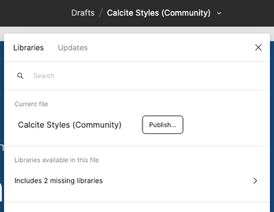

    1. It should take you to this modal
    2. Now, this is where it gets tricky. Figma may tell you "Includes x missing libraries". This introduces a world of confusion. This is telling you that the diagram has references to assets that are not present. The references may not be in use "Missing library with no components", but this is an issue for ESRI to resolve. There's options in Figma to swap libraries, but we can't do that on the official distribution, it's best to just Ignore the warnings.
