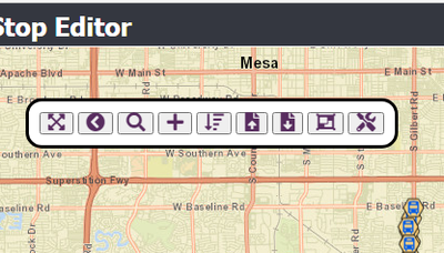

Dojo has a library for dragging DIVs called "dojo/dnd/Moveable".
In an app I'm working on I have a draggle window for tools.
To this I have a div on the page with a whole bunch of buttons for tools:
<div id="toolsDiv" style="z-index:100;">
    <button id="btnFullExtent" class="ui-button" title="Full Extent">
        <i class="fas fa-expand-arrows-alt fa-lg"></i>
    </button>
    <button id="btnPrevExtent" class="ui-button" title="Previous Extent">
        <i class="fas fa-chevron-circle-left fa-lg"></i>
    </button>
    <button id="btnSearch" class="ui-button" title="Search">
        <i class="fas fa-search fa-lg"></i>
    </button>
    <button id="btnAddStop" class="ui-button" title="New Stop Button">
        <i class="fas fa-plus fa-lg"></i>
    </button>
</div>
Which sits within a DIV 'wrapper' that also has the map div init:
<div class="wrapper">
    </div>
    <div id="viewDiv" class="map"></div>
    <div id="loadingDiv" class="loading"><img src="./resources/Loading.gif" height="100" width="100" /></div>
</div>
And CSS to render the tools Div:
#toolsDiv {
    padding: 10px;
    border: 3px solid #000;
    background: #fff;
    position: absolute;
    left: 150px;
    border-radius: 15px;
  And then a call to instantiate the library:
let toolsDiv = new Moveable(dom.byId("toolsDiv"));
After that the the div can be dragged anywhere within the wrapper div.
