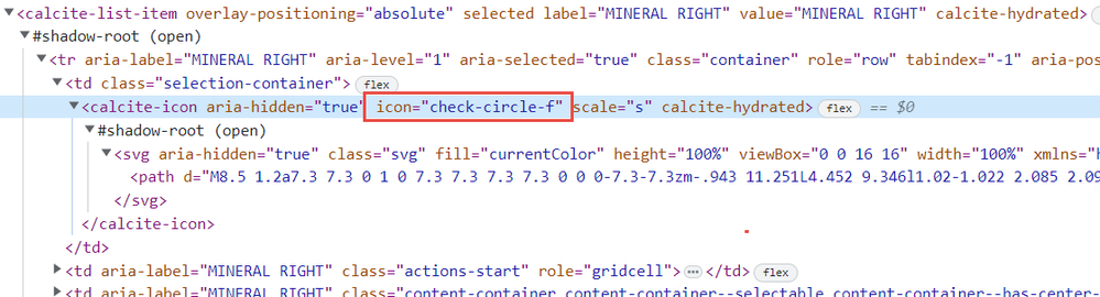

Before replacing the deprecated pick list item with the calcite-list-item, the selection-appearance icon defaulted to a simple check. I think the calcite-list-item selection-appearance icon looks really bad, especially with my design. I would like to override it or not show it at all.
(BAD) calcite-list-item
(GOOD) calcite-pick-list-item
How do I change the icon to 'check' in JS or CSS?

Why can't you change it to icon="check"  or don't use the icon so to remove it.
GregoryBologna
I probably could reach it with the code below, but I'm not exactly sure where in the action icon is the shadowRoot to change.

KittyHurley
Thanks for reaching out @GregoryBologna! It might be helpful to understand a bit more of the use case, and what you are aiming to achieve.
At this time the List component doesn't support changing the selection-appearance="icon". It looks like from above you have implemented it for selection-mode="multiple" types.
We do offer a selection-appearance="border" as an option, but that might not fit the use case you're seeking?
We also offer a slot for individual List items, such as "actions-end" and "actions-start" to add in customized icons for actions with icons.
Could you follow-up with some additional context/support with the user interface (UI) you are building? We might be able to open an enhancement request for consideration.

Hi. Thank you for helping me. You can see it in action here or try it at the URL below. Also, I added the code below. Basically, the pick list item uses a very acceptible check icon. I could change the calcite-list-item icon in Chrome devtools, but I cannot find where to override it in code. It sounds like I may need to just go back to using the pick list until calcite-list supports more icons.
