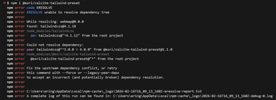

I got error installing Calcite Tailwind Preset:
DitwanDPrice
Hey Forrest, it looks like the issue is due to the version of "tailwindcss" you currently have installed (4.1.18). The Tailwind preset expects a version in the range ^3.0.0 < 4.0.0. You can try uninstalling your current "tailwindcss" version and then reinstalling the Tailwind preset package.

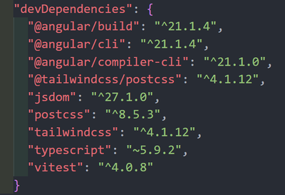

When I create an Angular project, the tailwindcss (4.1.18) is created. I can't uninstall it.
Thank you!
