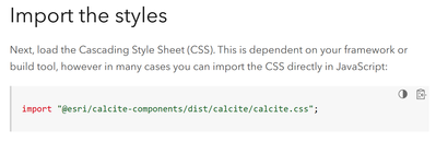

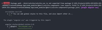

Importing the styles for Calcite Components 5.0 doesn't work:

Looks like that documentation page hasn't been updated yet. The package.json for v5.0.0 specifies a "./main.css" export. Try using this import statement instead:
@import "@esri/calcite-components/main.css";

Yes, it works.

Hey Forrest, the “Import the styles” section of the Get Started page has been revised to reflect the updated behavior. Additionally, a note regarding CSS asset imports has been included in the Angular sample app setup instructions.
