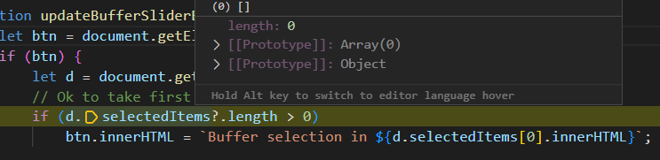

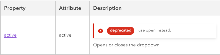

If I change 'active' to 'open' for this deprecated property, selectedItems is empty.
https://developers.arcgis.com/calcite-design-system/components/dropdown/
Creating dynamic dropdown
let opt_item = document.createElement('calcite-dropdown-item');
opt_item.setAttribute('id', 'pao-unit-feet');
opt_item.setAttribute('active', '');
opt_item.setAttribute('data-unit-abrv', 'ft');
opt_item.innerHTML = 'Feet';
grp.appendChild(opt_item);
OK Use opt_item.setAttribute('active', '');
Change to opt_item.setAttribute('open', '');

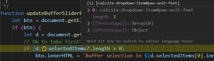

Hi @GregoryBologna, the calcite-dropdown deprecated the "active" property, in favor of "open" as you mentioned. However, the calcite-dropdown-item still uses the "active" property to indicate whether the component is selected.
As a side note, calcite-dropdown-item must have a parent calcite-dropdown-group. Not sure if you've already implemented into the code previously, so providing some additional context.
Here's a Codepen sample creating the dropdown items dynamically to the calcite-dropdown-group. When accessed, the accompanying calcite-button, "Get selectedItems" will log calcite-dropdown's "selectedItems" object length to the console.
