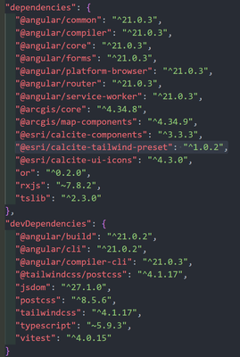

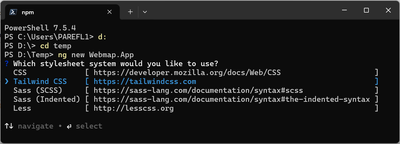

ForrestLin
How to use calcite tailwind preset package?
I tried to install the package: npm i @esri/calcite-tailwind-preset, and I got error:
Successfully installed by running
npm i @esri/calcite-tailwind-preset --force or --legacy-peer-deps
I got:
I need to import it in the Tailwind CSS configuration file:
import calcitePreset from "@esri/calcite-tailwind-preset";
export default {
       presets: [calcitePreset],
       content: [ /* ... */ ],
Where is the Tailwind CSS configuration?
