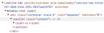

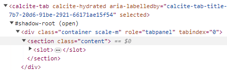

With the new Calcite 1.10.0 components, a vertical scroll bar is now showing up in the calcite-tab component.  I've noticed that the "content" class of the shadow-root for calcite-tab now has a new property that adds a padding-block of 0.5rem.
Here is a Codepen showing the result: https://codepen.io/fcbasson/pen/rNPjPYM
Removing or disabling the "padding-block" property also takes care of the vertical scroll bar.
This behaviour manifests in a calcite-tab (with a calcite-tab-nav)  hosted inside a calcite-panel.  It does not happen with Calcite 1.9.2 components.
How can I get rid of the extra padding and vertical scroll bar inside the calcite-tab?
