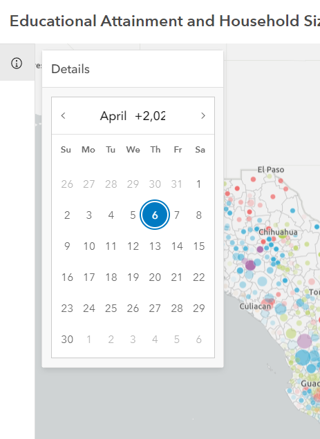

I'm new to Calcite and have been having trouble with entering a year in the Date Picker when I use an alert.  If an alert has been open, than the Date Picker year entry box doesn't seem to function properly.  Once the user selects a date after the incorrect year appears than the date picker works again.
Here is a codepen using the calcite sample with a datepicker and an alert.  Thank you and I appreciate any help on this.

KittyHurley
@CurtisWursten1 Thanks for reaching out - we've logged a bug to address the conflict in #6781.
