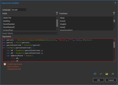

Josh thanks for the advice. I tried that in the past. Here is the new error....
jcarlson
MVP Alum
So, that means that there's nothing in the intersection.
Instead of checking IsEmpty on the centroid, check first on the parcels FeatureSet.

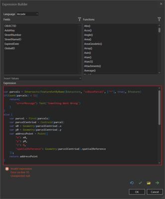

The same error occurs just in the else statement. So it sees the intersection,
Some reason just having an issue with getting the centroid geometry still. Not sure this is even possible.
