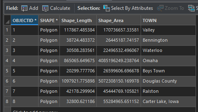

I tried a few different ways to check if the result is null, but I ultimately realized the resulting feature set is not the issue. The issue occurs only when I try to access the field name TOWN in the result. If I set the result to be 'MUNICIPALITY': cityLimits (removing .TOWN), the expression still validates and I am actually able to save the rule. It's only a problem when trying to access the TOWN attribute in the City Limits fc.
Just to be on the safe side, I created a brand new feature class in a file geodatabase and copied the features manually into it so there wouldn't be any chance of overhead or corruption. The layer has a total of 8 features, none of which have a null TOWN value:

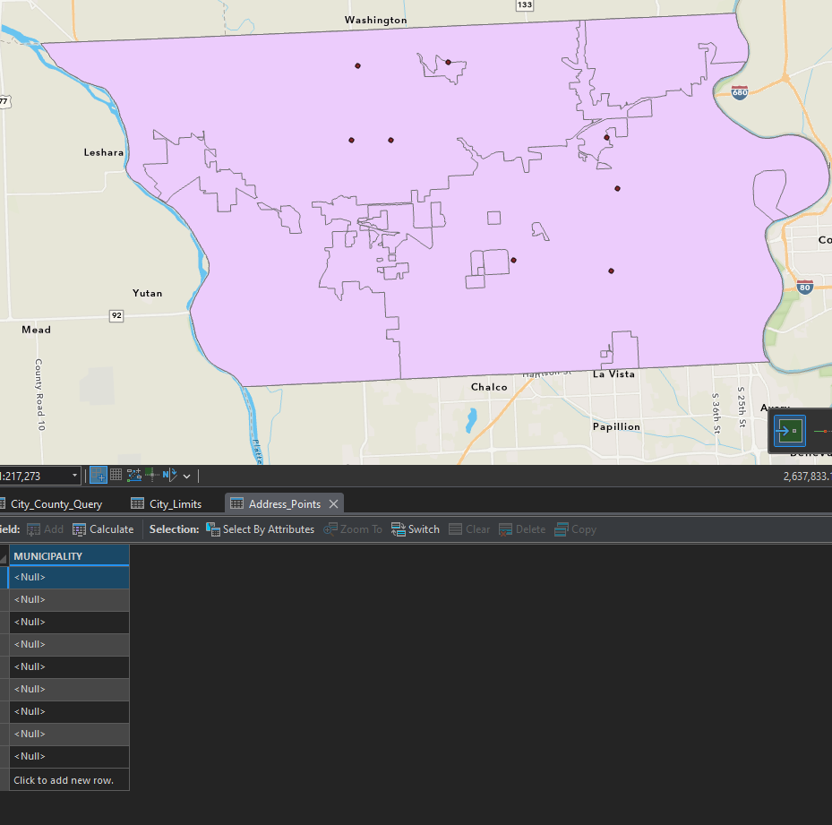

Thanks Nasser. I guarded against null, and I was able to save. I'm not getting any result from the attribute rule though. When I add a point, the MUNICIPALITY value remains null. It's as if the action of creating a point is getting a null cityLimit and then returning empty.
Here's my rule as it stands now:
var fs = FeatureSetByName($datastore,"City_Limits",["TOWN"],false);
var intFs = Intersects(fs, Geometry($feature));
var cityLimit = First(intFs)
if (cityLimit == null) return;
return {
   'result':{
      'attributes':{
         'MUNICIPALITY':cityLimit.TOWN

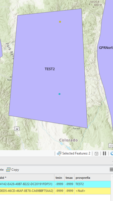

 The problem that I am having is that in some areas of the polygons when I create points the return value from my rule is null when it should return a value. There are several polygons that do this and the pattern seems random. I have deleted the polys and re-created them with the same result.
Here is one example where the point near the bottom of the poly calculated correctly and the point at the top comes out as null.
Any suggestions would be very greatly appreciated.

hey Katherine
i see this is a direct connect sde connection,
can you try on a filegdb and see if you see the same behavior?
and also is it possible to send a data (with just one "bad" polygon) that reproduces feel free to take any fields/ data that is not relevant.
your code looks correct so my guess it might be the spatial reference ..

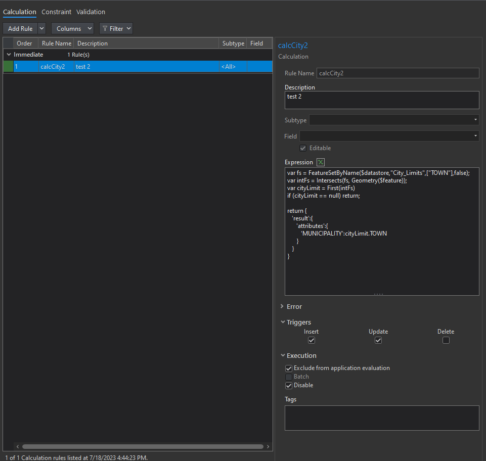

MikeMillerGIS
Esri Frequent Contributor
Can you post your sample GDB for us to test out?
MikeMillerGIS
Also, on your screen shot, the rules is disabled, make sure to enable it
