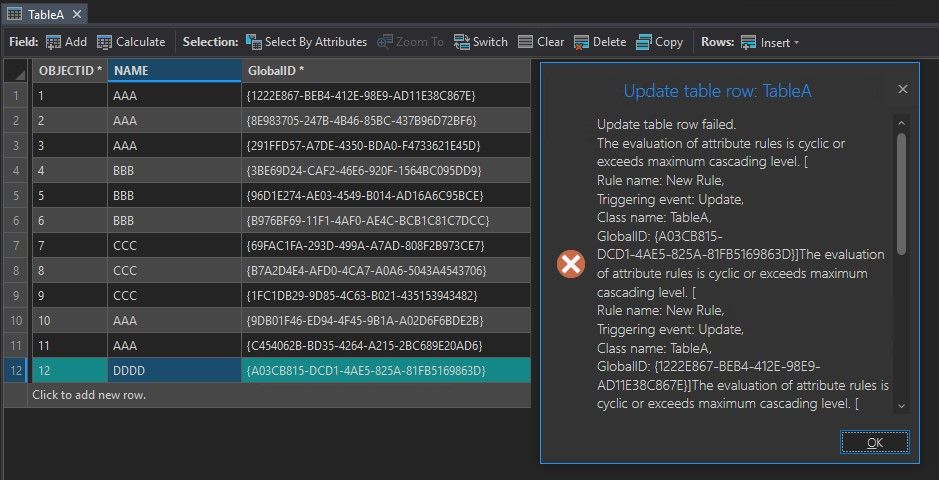

Following the immediate calculation rule example for updating features in the same feature class (calculation rule update a record in the same feature class), I have come across a mysterious problem that results in two different scenarios, seems to be caused by the difference in the number of features that share the same attribute as the one being edited.
The rule will trigger an error if the number of records sharing the same attribute is greater than five. However, if the number of records sharing the same attribute is less than six, it works as configured.
For example, there are six records that have 'AAA' in the 'NAME' field in the table below. In this case, the calculation ends up with an error, displaying the message "evaluation of attribute rules is cyclic or exceeds the maximum cascading level." However, the calculation works as configured if the records with 'AAA' are less than six – please see the pictures below.
I have used the code from the thread and only altered the feature class name and field name. Any clue would be appreciated.
Gets error if features are more than five. Tried to edit AAA to DDDD.
Error - if other features more than fiveError - if other features more than five

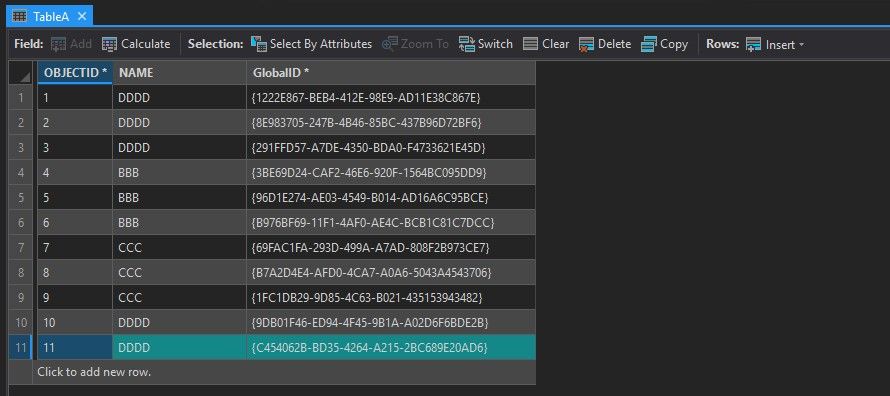

Works if features are less than six. Edited AAA to DDDD
Works - if other feature less than sixWorks - if other feature less than six
