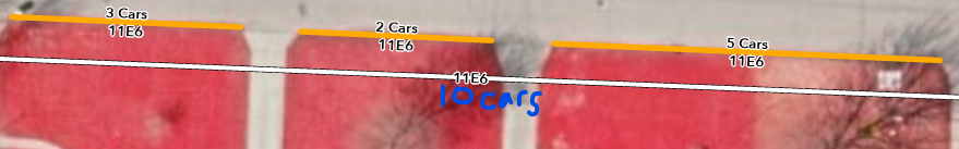

Example:
Three "StreetParking" segments (orange) contain different available parking based on length. They also contain the same GIUD (11E6 - last 4 of GUID) as the "CapacityBlockface" (white). On the insert, update, or delete of a "StreetParking" feature, I want the total number of cars between all that share a GUID to be pushed to the blockface feature field ['Capacity']. Therefore 11E6 will have 10 cars.
Using this code, I can return the total number of cars through console, but I am running into issue when trying to return it to the "CapacityBlockface" layer. I get the error "Dictionary Type Expected"  on the GlobalID on line 18.
Any input would be greatly appreciated!!
