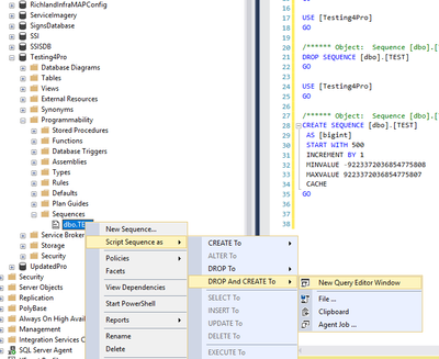

SQL server can easily script the drop/create of the database sequence.  No example (and haven't tested), but one option would be to put an insert trigger on the table and check if the number has reached 999999, if so, drop/re-create the sequence.
You can follow the image below to see how to have SSMS create the drop/create SQL for you:
