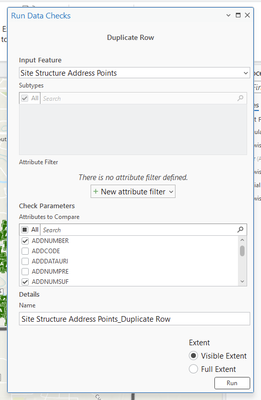

If you're only comparing attributes, you could try using the new Duplicate Row check. This check identifies features that have duplicate attribute values in one or more columns.
This check was created (in part) to address a NG911 use-case to identify duplicate features with the same attribution in the same or different locations.
