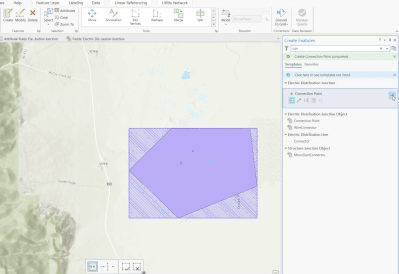

HusseinNasser2
It is not recommended to change the $feature attributes through edit dictionary, the AR loses context and you can get into cyclic triggers and infinite loops. No different than recursion in programming.
Instead, set the field type to null and use the result dictionary object, this way we are able to update the attributes of the new feature in row buffer and flush it once to the database.
After rewriting your attribute rule with this mind it works. I just changed asset_number to labeltext which is the field i had on my UN (see gif) 
