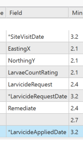

I did notice these weird *'s in front of some of my fields. They are not actually a part of the field name. They appeared when I restored a backup of the files. I had deleted the wrong files! Could that be the issue?

I'm not seeing any obvious issues with the rule so maybe the backup restore process was the culprit? Another thing to check is the new "Triggering Fields" option for Attribute Rules if that's applicable.
JamesBooth
Hmmm, I hope not lol! I have seen the Trigger Fields option. Unfortunately we're still on 3.3 and I believe that is a new option in 3.4.
JamesBooth
Turns out the edits were happening, just a bit slow and I had to refresh my view. Thanks though!
