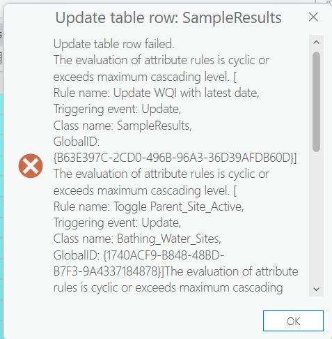

Hi - I would love some help please. I'm trying to write an attribute rule on a relationship class that will update an attribute on the parent record if the most recent child record is updated. The parent class is sampling sites and the child class is samples. So if an attribute on the most recent sample is set (Public_sample_date attribute), then the attribute on the site itself should be updated too. But I'm getting an error....
I am getting this error...
My code is below...

I think your listing missed the line where you grab the child's parent, but either way: that error is a sign that you have a parent to child update going on — either from an attribute rule on the parent or a composite relationship class — that retriggers the child, which retriggers the parent, and so on. Check what you have going on in the parent and look for potential loops. In some cases you can fix this by comparing fields in the $feature with matching fields in the $originalfeature and returning early if there were no changes.
johnchewitt77
Hi David - I really appreciate the reply, thanks a lot. You were right, I'd omitted the first few lines by mistake so they are now added. If it helps, I commented out the last part that updates the attributes and the code worked i.e. it does populate the latestWQI value, so I'm guessing the problem is with the last bit that updates the parent attribute.
