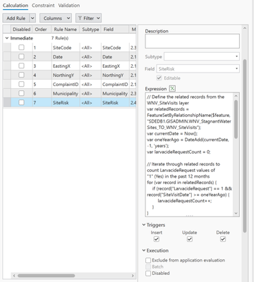

JamesBooth
Thanks for your response Jake! I appreciate your assistance very much! I'm completely new to Arcade and I'll admit I'm using AI tools to assist, which is why I'm likely having issues. My relationship  between WNV_StagnantWaterSites and WNV_SiteVisits is actually 1:M. I have one WNV_StagnantWaterSites record with multiple WNV_SiteVisits records. Both are point feature classes. Parent represents the Stagnant Water Site. Child records are point locations surrounding the stagnant water site. Staff want to know specifically where students are collecting on a pond as an example.
I tried your suggestions of using GlobalID instead of ObjectID and I also removed the return null, and just have return. Unfortunately, I still don't have my SiteRisk level changing. Even if I trigger the rule by applying a LarvacideRequest = "1" (Yes), nothing happens to the SiteRisk in the parent point feature layer. My updated syntax is at bottom.
I also wonder what my execution parameters should be set at. This is what I have:
// Define the related records from the WNV_SiteVisits layer
var relatedRecords = FeatureSetByRelationshipName($feature, "SDEDB1.GISADMIN.WNV_StagnantWaterSites_TO_WNV_SiteVisits");
var currentDate = Now();
var oneYearAgo = DateAdd(currentDate, -1, 'years');
var larvacideRequestCount = 0;
// Iterate through related records to count LarvacideRequest values of "1" (Yes) in the past 12 months
for (var record in relatedRecords) {
    if (record["LarvacideRequest"] == 1 && record["SiteVisitDate"] >= oneYearAgo) {
        larvacideRequestCount++;
// Determine the new SiteRisk value based on the count of LarvacideRequest values
var newSiteRisk = "";
if (larvacideRequestCount == 0) {
    newSiteRisk = "Low";
} else if (larvacideRequestCount == 1) {
    newSiteRisk = "Moderate";
} else if (larvacideRequestCount >= 2) {
    newSiteRisk = "High";
// Update the parent record's SiteRisk field if it needs to be changed
if ($feature["SiteRisk"] != newSiteRisk) {
    return {
        "edit": [{
            "className": "SDEDB1.GISADMIN.WNV_StagnantWaterSites",
            "updates": [{
                "GlobalID": $feature["GlobalID"],
                "attributes": {
                    "SiteRisk": newSiteRisk
// End the expression evaluation if no update is needed
return;

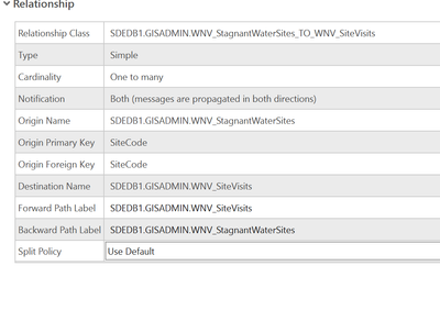

Jake_S
by Esri Contributor
@JamesBooth my apologies, I glossed over the initial part not realizing the relationship was 1:M.
Few questions,
Can you provide a screenshot of that relationship properties?
catalog > right click relationship > properties
Also are you able provide empty data sets for the schema (create a copy and delete the contents)? If not that's fine.
I's want to test a solution.
~Jake
