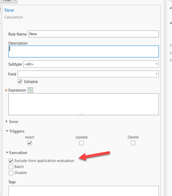

Hey @Chip727
Can you try to Exclude the rule from client evaluation and confirm if the error goes away?
Make sure this option is checked.

HusseinNasser2
Hey @Chip727
Chip727
@HusseinNasser2 This worked! The attribute rule is now working when data is submitted from Field Maps. Thank you!
