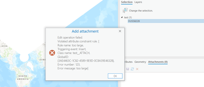

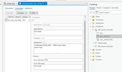

So you want to add a constraint rule on the attachment table that says something like this
if ($feature.DATA_SIZE > 1000) return false;
return true;
HusseinNasser2
return true;
BHK
Thanks Hussein, This is exactly what I was looking for
