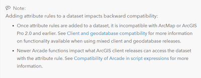

See also the notes in this link: Introduction to attribute rules—ArcGIS Pro | Documentation
