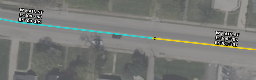

I've created an attribute rule to identify two road segments that have been merged using the Merge (Editing) tool and "merge" the address ranges together. In order for it to work successfully, the user must be sure to select the FIRST segment of the two being merged in terms of line direction to preserve attributes from in the Modify Features pane (the yellow highlighted segment in the screenshot below). The attribute rule fires on Delete, since a merge should consist of a Delete and an Update (when choosing to merge into an existing feature rather than a new feature). The rule successfully identifies another feature in the roads layer that has the same street name and whose end point is equal to the start point of the deleted feature - this should be the feature that is updated during the merge. I recognize this may not work perfectly in all scenarios but for now I'm just testing if possible to get this to work at all.
Both the deleted and updated feature from the merge are correctly identified within the attribute rule, and it successfully identifies the address ranges of both and performs calculations to ensure the ranges are compatible for merging and correctly sets the final "merged" range values (keeping the from left and from right ranges from the first/updated segment, and the to left and to right ranges from the second/deleted segment).
I then try to update the range fields in the first/updated segment using the Global ID. The rule runs successfully with no errors, but despite confirming that the final calculated ranges for the merge are correct using Console messages, the updated segment has the same address ranges as it originally did after the rule fires.

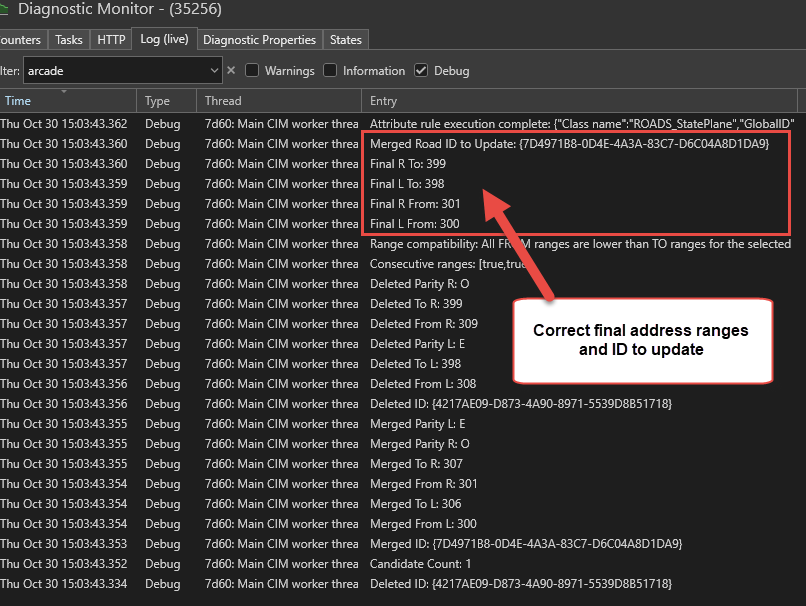

// These console messages print out the correct final ranges
Console("Final L From: " + Text(final_L_from));
Console("Final L To: "   + Text(final_L_to));
Console("Final R From: " + Text(final_R_from));
Console("Final R To: "   + Text(final_R_to));
// This console message prints out the correct ID to be updated
Console("Merged Road ID to Update: " + Text(mergedRoad.GlobalID));

Here is a screenshot of the Console messages:
