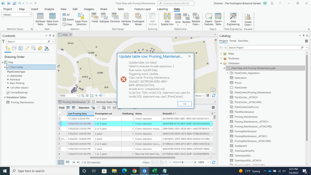

I tried using it on the data from the SDE, but now I'm getting an error that I hadn't gotten before: Screenshot (14).png
Not quite sure what that is about. The parent class has the appropriate field.

That is interesting for sure. I wonder since you're using the data from the SDE it is now wanting you to provide the fully qualified name for the relationship class as well as the parent feature class. So for example, "PlantCenter2Pruning_Maintenance" now becomes "xxxxxxx.DBO.PlantCenter2Pruning_Maintenance". Same with "PlantCenter" becoming "xxxxx.DBO.PlantCenter".
I also noticed you guys have GlobalID_1 rather than just GlobalID. I'm not sure if that would cause any quirks.
dommybo123
You were right on both ends. Changing the naming made the attribute rule work as intended. Thanks for pointing that out! For some reason, even though this data is stored in the SDE, the attribute rules are still not working when I publish the Web Map and make updates using Field Maps. From conversations with Esri staff, it sounds like there just isn't widespread support for attribute rules on AGOL or Field Maps yet. I might try to run a Python script that can effectively achieve the same goal, but just runs once nightly. Thanks for all your help, and if you can think of anything else to try let me know!
